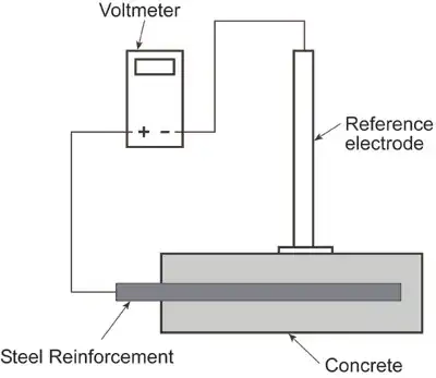

I am trying to perform some measurements based on a special technique used to detect corrosion in rebars of concrete bloc. The idea is to measure the potential difference between an electrode and the rebar:
I tried it with a conventional voltmeter. It worked just fine. The potential difference lies between 0V and 1V.

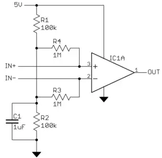

As has already been mentioned, your circuit doesn't work because you violated the amplifier's common mode range. This is yet another example where reading the datasheet carefully would have avoided a obvious mistake.
A simple fix is to get a amp with common mode range that extends to ground. However, you can easily bias the amp you have near the middle of its range like so:
R1 and R2 form a voltage divider to make 1/2 the supply voltage. C1 attenuates nasty frequencies that might be on the supply that are high enough so that the amp's active circuitry can't eliminate the noise as common mode signal. R4 and R3 apply this 1/2 supply bias voltage to each of the inputs.

  • Does this solution assume we know the impedance of the voltage source, and that the impedance is constant ? – Rocketmagnet Apr 15 '12 at 17:04
  • @Rocket: It assumes that the voltage source can handle 2 MOhm differential. This is the same loading that the OP applied in his original circuit, so I just copied it since we have not been given any other specs. This is basically the OP's circuit with the two 1 MOhm resistors going to 1/2 the supply voltage instead of ground. – Olin Lathrop Apr 15 '12 at 17:19
  • Yeah, I was a bit dubious about his pull down resistors for the same reason. I mean, isn't the point of an InAmp to cope with very high impedance sources? How much drive does a piece of concrete have anyway? – Rocketmagnet Apr 15 '12 at 17:23
  • @Rocket: InAmps do generally have high imput impedance, but that's not the only reason for using them. The main point is true differential measurement with a fixed and known gain. Sometimes high imput impedance is require, but sometimes not. I don't know what the impedance of the concrete and rebar battery is, but 2 MOhm sounds high enough to measure its voltage. – Olin Lathrop Apr 15 '12 at 17:55
