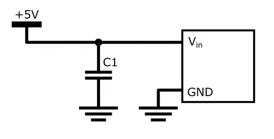

We often see something like this on our schematic:
schematic decouplingcapacitor ideal
When we place this on the pcb, it looks like this:
PCB decoupling capacitor

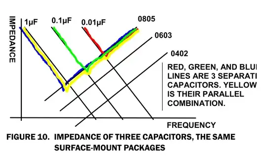

So, what happens if we now get more capacitors? Let's say we choose a 1uF, 0.1uF and 0.01uF capacitor, in an 0805 formfactor. If we now put them together, we get the following plot:
enter image description here Source: Tamara Schmitz, Mike Wong, Intersil Application Note 1325: Choosing and Using Bypass Capacitors
What we see is that even though we added smaller capacitors, we don't really get any significant benefit - the inductance causes our impedance to go up, removing all benefit of the smaller capacitors.
What we should have done is use 3 different packages, say, 0805, 0603 and 0402. This would have given us the following figure:
