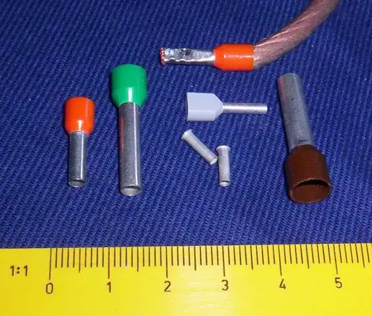

If you want to do your installation a favor, use wire ferrules:
Wire Ferrules
Image source: http://de.wikipedia.org/wiki/Aderendh%C3%BClse?uselang=de
Do not, ever, tin the wires. A tinned wire will slowly give way to the screw's pressure and eventually become loose. The contact resistance will rise. In the worst case, your contact will become hot and cause fire.
If you don't have wire ferrules at hand, just twist the stranded wire before putting it into the terminal block. While not recommended because some strands might cause shorts to neighboring terminals, this will still be far better and reliable than a tinned wire.

    These are the types of termination I specify for production. Gives a much cleaner finish and doesn't lead to wire fraying over time with insertion/removal cycles. – akohlsmith Apr 14 '12 at 18:38
