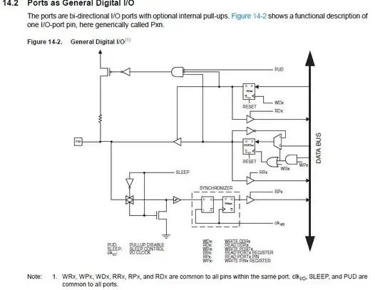

This is the IO port of ATMEGA328p according to 76 page of datasheet.
ATMEGA328p GPIO
As I know, Pull up is the most suitable system because lots of voltage spikes are logic 1.So, if we can give logic 1 normally, we can avoid unwanted triggering causes by spikes.
This thread has some explanation. But,it can't satisfy me.because ATMEGA328p port is bi-directional.
Explain what is the most suitable way(pull up/pull down) when we use a button input to the port with help of diagram above.

The ATmega328p I/O block only provides pull-up functionality. There is no internal pull-down. I've circled the relevant bit of the circuit in the diagram below -- notice that there is no "mirror" of this circuit to pull the pin to ground.
(It is, of course, still possible to drive the pin to a hard low. However, this is not suitable for use as a pull-down; the pin will always read as low if it is being driven low, and the I/O block may be damaged if it is forced to sink more than its limit of 40 mA from a pushbutton.)
If you disable the internal pull-up resistor, you can certainly hook up an external pull-down resistor. There is no significant advantage to doing so, though, especially for a low-speed I/O like a pushbutton.
ATmega328p I/O block, with pull-up circuit circled
