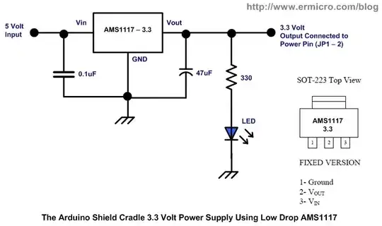

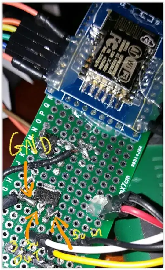

Here is the way I hooked it up:
The document I am reading is here
And also on my breadboard:
And what I have it connected to (ESP8266 ESP-12f) this is its document stating above 80mA average:

Alright does this look like a good one to go by?

    Did you include input and output capacitors? Does the regulator draw current or get warm? Are you sure they aren't fakes? – pericynthion Apr 02 '17 at 06:51
    You need a minimum load too, on top of @pericynthion capacitors. – winny Apr 02 '17 at 07:20
    The output capacitor probably has a minimum ESR requirement as well: https://electronics.stackexchange.com/questions/200565/capacitors-for-ams1117-for-5v-to-3-3v-regulation – Peter Smith Apr 02 '17 at 13:40
    Two things. One, your soldering is horrible. Two, the chip pins are too small to fit in the breadboard properly like that. Bonus, are you sure you got real chips? They may be fake or broken. Especially if all 3 are like that. – Passerby Apr 03 '17 at 03:01
  • Solder some wires onto a new regulator and put it in the breadboard with just input power and no load. If you don't get 3.3V it's a fake. – Bruce Abbott Apr 03 '17 at 03:29
You have the 3.3V version not the adjustable version as shown by the part number.
See the datasheet under electrical characteristics: the regulator wants a minimum load of 10mA. If you directly measure the unloaded output, your multimeter's impedance is too high for the chip to regulate.
Page four of your linked datasheet also states that the output capacitor is not optional.
