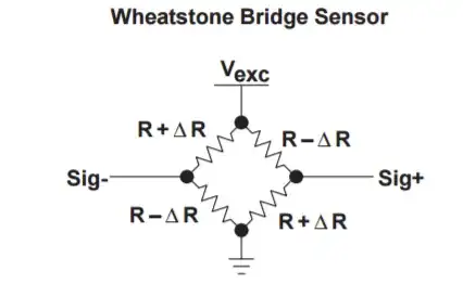

Above is the definition of differential signaling. The Wheatstone bridge is under the category balanced differential signaling since it has mirrored signaling output around a common mode voltage:
Vsig = (Sig+) - (Sig-) Vsig = Vexc * ΔR/R
The strain-gauge I will use basically uses a full Wheatstone bridge. Here is the data-sheet. And here is the basic specs:
On the definition of sensitivity: 500με/mV/V means if the sensor is excited using 1V input and reads 1mV output, it corresponds to 500με strain. If the input excitation is 2 Volts, then the same 500με strain would yield 2mV output.
The measurements will measure +-100με which means the output will be 0.2mV at 1V excitation. The datasheet says the max possible excitation is 10V. So I will use a 9V power supply for the excitation which means the output Vsig will be max around 1.8mV.

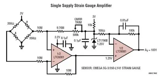

And in the second link from LT, there is a schematic. But when I download their simulation, it is different than in their figure in the link and it is as below:
This above is different than their schematic:
In the first schematic R11 is 100 instead of 100k and the it is using +-15V power supply not a single supply.

To answer your question about the LTC6081, I would say it is used for the following reasons:
  1. Low noise
  2. High CMRR (100dB)
  3. High PSRR (98 dB)
  4. Rail to rail operation
Besides all that, it can operate on a single 3.3 or 5V rail. This makes easy to use in typical circuits where you have those voltages available for the other circuitry (such as an ADC and/or microprocessor.) Easy to use in that you don't need a separate supply for the opamp.
