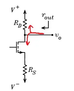

Now let us look at \$rout\$. If we are looking from the load perspective we can see two paths for a AC current to flow:
First through \$R_D\$ resistor.
And the second one through MOSFET channel -->\$R_S\$ into GND.
As you can see now \$R_S\$ resistor is in series with the MOSFET channel.
So, to find resistance seen from the drain terminal into the MOSFET we need to use a small-signal-model.
\$r_x = \frac{V_X}{I_X}\$ and because \$V_G = 0V\$ we have:
$$V_{GS} = -I_X*R_S $$
And from KVL we have
$$V_X = I_{ro}*ro+I_X*R_S$$
$$I_{ro} = I_X - gm*V_{GS}$$
$$V_X=\left ( I_X - \left (gm\left ( -I_X \right )R_S \right ) \right )ro + I_XR_S $$
And solve for \$I_X\$ $$I_X = \frac{V_X}{ R_S + ro + gm*R_S*ro} $$ And finally we have $$r_x = R_S + ro + gm*R_S*ro = ro(1+gmR_S+\frac{R_S}{ro}) $$
$$r_x = ro*(1+gmR_S)+R_S $$
As you can see adding \$R_S\$ resistor increase the MOSFET resistance.
The \$ro\$ is boosted by a factor of \$(1+gm R_S)\$
So, the overall \$r_{out}\$ is equal to:
$$r_{out} = R_D||r_x $$
and because \$R_D<<r_x\$ we have \$r_{out} \approx R_D\$
G36
  • 13,642
  • I don't know what to say. I was really hoping for that kind of answer - you explained me everything! I hope this answer gets more up-votes :D – Keno Mar 31 '17 at 21:02
  • One more thing: You said "rout = Rd || rx". What about "ro" - the channel resistance which equals "1/gm"? Can it be added in parallel with Rd and rx for more aproximate result/value? – Keno Mar 31 '17 at 21:06
  • Or not? Because it is already added to "rx"? – Keno Mar 31 '17 at 21:33
  • @Keno When you are looking into the MOSFET drain terminal and the MOSFET work in saturation region. You will newer see 1/gm. – G36 Apr 01 '17 at 16:48
