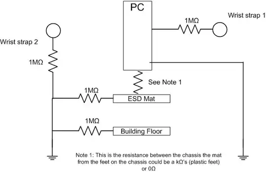

If look at this question the diagram would look like this, the grounds would be connected in the building wiring:
In the above image the wrist strap is connected to the mat, if it's the kind with a 1MΩ resistor in it, it doesn't matter where you connect it, if you connect it to the chassis (shown as wrist strap1) , it still gets grounded. If you connect the wrist strap to the mat it gets grounded, and if you connected it to the mats ground (shown as wrist strap2) it still gets connected, each time with at least 1MΩ to ground or any other potential that might affect those who might grab onto earth mains. If you take a 1MΩ resistor and poke it into an electrical outlet it's not going to kill you, but a fork might.
