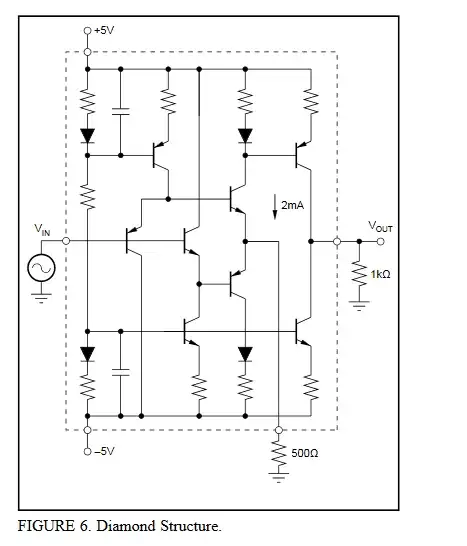

  • http://www.ti.com/lit/an/sboa071/sboa071.pdf – user3528438 Mar 24 '17 at 18:19
  • I glossed over that because the other part looked better, Thanks – Voltage Spike Mar 24 '17 at 18:24

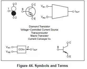

  • Actually, to answer my own question it is "a diamond transistor", but a diamond transistor is a configuration of transistors, not a transistor made of diamonds. "The monolithic integrated circuit OPA660 uses the Dia- mond structure to act as an ideal transistor" – Voltage Spike Mar 25 '17 at 05:47
  • It is traditionally referred to as a diamond buffer. Extremely high speed current amplifier. – dannyf Mar 24 '17 at 19:02
It's a particular complementary BJT circuit arrangement as so:
Which behaves similarly to transistor that does not have a Vbe offset and biasing issues, as explained in the link which @user3528438 also provided in a comment.
It's made with Burr-Brown/TI's high performance silicon analog IC process, not carbon-based.

This document from TI says it is a particular configuration rather than exotic materials
I also found other references to the diamond structure that also refer to it being a particular circuit configuration.
