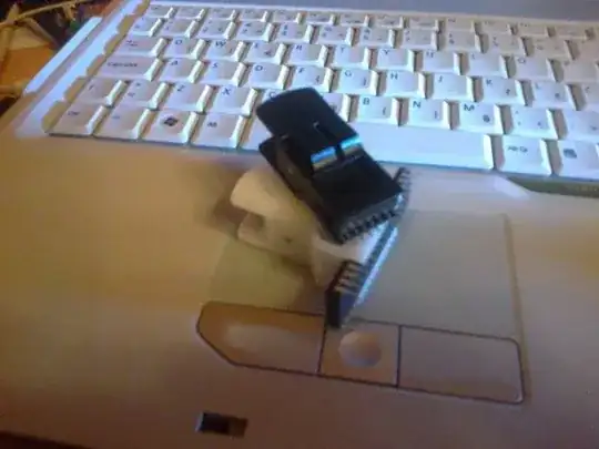

For DIPs, I've seen two basic types of tools. One which grasps the DIP under the long sides and one which grasps the DIP under the shot side and both have their uses.
If the component is close to the board, sometimes the pins of the long extractor won't be able to reach under it and it can be difficult to remove the DIP. In that case the short end extractor is more useful since on the breadboard there us usually a trench under the DIP and there will be enough room to insert the extractor. The downside of the short end extractors is that you can lift one side of the DIP with them and leave the other in the breadboard which usually causes pins to bend. Also sometimes considerable force may be needed to actually operate the extractor which increases the chances of DIP slipping and flying off once it has been removed from the breadboard.
On the other hand, the long side extractors apply force more evenly along the DIP and the change of DIP pins getting bent is lower with them since practically all pins get removed at the same time.
narrow and wide extractors
Unfortunately, Google can't find the long-side extractors such as ones I have, so this blurry image will have to serve as illustration.
EDIT: I managed to find a link to the narrow one.
