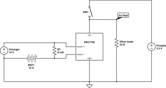

Here is a schematic of how the product is laid out:

So, my main question is: what is happening when I disconnect Vsupply while a battery/charger is connected and the PAC1720 starts smoking?
Any way that I can solve this problem now that the product is in production?

I think with bias they mean the combination of the 5.2 V zener diode and the 100k to 1M resistor. So the zener diode is providing a voltage to the chip making those parts work which protect the chip from the voltage across the sense pins.
So if you don't have that combination in your unit, you will fry the chip as soon as VDD is removed and nothing is left to power those parts.

It appears the chip needs a VDD applied before the SENSE pins are connected to the battery.
Your only option is thus to power it from the battery side, using a resistor and zener as shown in the schematics you posted, or even a voltage regulator.
Since its IOs are open collector (or open drain) it can be powered while the rest of the circuit (SMBUS side) is unpowered. It will not send voltage to your unpowered micro.
Now, when the microcontroller is powered but there is no battery, the SMBUS pullups will let some current enter the inputs of the unpowered chip. I don't know if this would be a problem.
When in doubt... My solution would be to use a Diode-OR from both the battery and your 3V3 supply.

The biasing thing means :-
You MUST have the power turned on to the device before you attach the battery OR turn on the charger.
It also means don't turn off the device before you disconnect the battery AND the charger.
In other words. when connected as shown SW1 literally = KILL SWITCH.
How do you fix it at this point.... maybe add a relay to disconnect the battery circuit both sides of the sensor resistor when vSupply is disconnected and enough bulk capacitance to keep the chip biased for the duration of the relay opening time.
