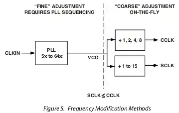

I don't even know if the DSP timer can output a signal that high, but it seems to have a decent VCO/PLL, meaning that you can probably even feed the DSP and the CODEC the exact same clock signal, and then have the DSP scale it up internally:

  • This is great information. Even though the codec didn't explicitly mention I2S, it definitely is implied after reading through your response. The Blackfin's SPORT interface should suffice the serial data clock and the channel select signal. That leaves us with the MCLK as you stated. I'm thinking that I just use a PWM output for MCLK. Looking through the manual, it states the highest PWM frequency is SCLK/2. And because I'm using the PLL to multiply my CLKIN frequency, this should be fast enough. However, I don't think it will be a perfect multiple. – Izzo Mar 21 '17 at 14:48
