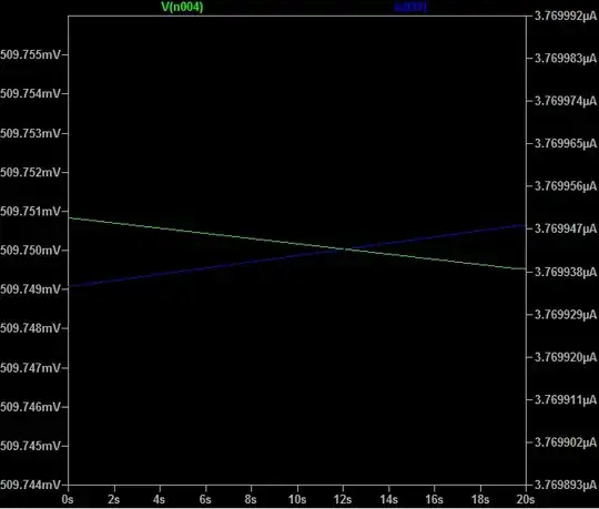

Here's the actual behavior of the circuit simulated in LTspice:
where V(n004) is the base-emitter voltage. As you see it doesn't agree with the above schematic. I'm actually trying to understand how I should modify the code to achieve the predicted result.
