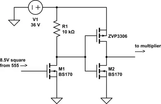

  • Replacing the MOSFET driver section with something like this:
I toasted quite a few transistors trying this inverter. As shown, the gates of the inverter are pulled up to 36V by the 10kΩ resistor. Is it possible that the gate charge time is what destroyed the transistors?
EDIT: I just realized that the maximum ratings for gate-source voltage on both inverter FETs is ±20V. That would explain why they fried. Hmm, maybe instead of a single 10kΩ, I could make a voltage divider to drive each gate separately?

  • You are probably shorting the two FETs on your push/pull config. There will be a moment at which both the devices will be on and shoot through will occur. – Wesley Lee Mar 17 '17 at 07:56
  • @WesleyLee I think it's that I'm driving the gates at voltages beyond twice their absolute maximum rating, but I think you're right even if it could handle those voltages. Like I said in the OP, the 10kΩ resistor might be charging the gates too slowly, causing too much shoot-through. – Yankee Mar 17 '17 at 08:43
    Wesley is right. Just limiting the gate drive won't do. Let's say the Vgs (on ) is 5V for each, which is on the high side for all but the most ancient FETs. That leaves 25V of range on the first signal where __both__ FETs are on. That's a lot of short-circuit. Driving FETs like this with a power capability requires an amount of dead-time in the drive signals and it may go into several to dozens of micro-seconds. – Asmyldof Mar 17 '17 at 08:51
    Also be aware that above 2~5mA output the batteries may start to significantly resist the peak currents required, which will still cause droop on the output as well, because these kinds of batteries are notoriously bad at handling decent currents. – Asmyldof Mar 17 '17 at 08:58
You need to ditch Rd from your first schematic, and use a low impedance push-pull output as in your second schematic. However, as you correctly say, 36v will toast the gates of 20v Vgs FETs. There are few fets with Vgsmax greater than 20v, and none to my knowledge with more than 30v.
