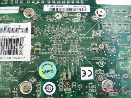

I guess it can't be that bad, because BGAs seem to use this technique in designs that are much faster than mine (a 67MHz MCU).
Decoupling capacitors under a BGA in a graphics card
