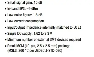

I would typically compare the small signal gain and noise figure first. One of the FEMs requires an external matching component but other that they are very similar in terms of cost and foot-print size.
I reviewed this website tutorial on the differences between -1dB compression and 3rd order points but still not sure how the point (-9dBm or -7.3dBm) will ultimately affect the performance or linearity of the amplifier.

The higher the better (other things equal), because more input power will be needed for the same amount of degradation in linearity. So you will have better dynamic range.
Also, intermodulation noise can reduce your effective \$E_b/N_0\$, thus increasing your bit error rate (BER). The sensitivity of your receiver will decrease.
