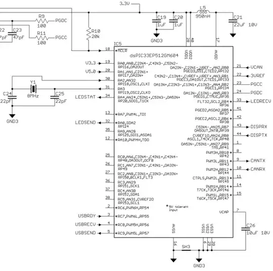

For reference, here is a snippet of the schematic showing this microcontroller and its power, ground, and crystal connections:
The point is to give the local loop currents good and short loops to flow over, and to keep these currents off the main ground. The main power and ground currents should only be the total power and ground current going into and out of the subsystem.
