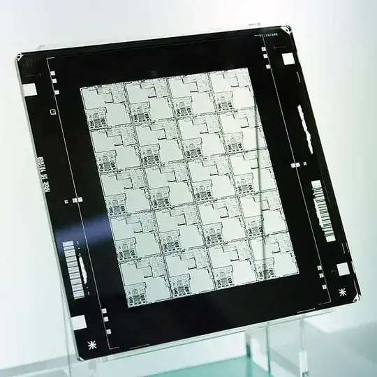

Something not mentioned by the other answers is that it's not only the chip itself that's so sensitive to dust. It's also the lithography plates used to print the resist layers for each stage of the process.
Image from Wikipedia
Incredibly advanced optics are used to project light through these essentially "film negatives" onto the resist layer on the wafer. These negatives are several times larger than the actual features to help reduce the effect of error in the plate, but feature size is only around 4-5x larger. The UV light is shown through them, and focused down to the appropriate dimensions to expose the resist at the appropriate resolution. With current process technology reaching down to 10nm, these litho plates have to be "perfect" because they rely on diffraction techniques to print features many times smaller than the wavelength of light used. If a spec of dust were to get on one of these plate, it would ruin every chip subsequently printed with that area of the litho plate.

    "slightly smaller" herein meaning 20x as (barring EUV) a wavelength of ~193nm is used, but anyway :) – Sam Mar 11 '17 at 07:08
  • @sam, It was in a class I took several years ago... I didn't bother to look up the exact value :P – Aaron Mar 11 '17 at 20:32
  • Not sure if this is true. According to [wikipedia](https://en.wikipedia.org/wiki/Semiconductor_device_fabrication#History), cleanrooms filter out particles, which could **come to rest on the wafers** and contribute to defects. If the features on the plates are 100 times larger than on the chip, it seems logical that plates can survive contamination by particles 100 times larger than wafers. – Dmitry Grigoryev Mar 13 '17 at 08:18
  • @DmitryGrigoryev 100x was a number I pulled out of my ass... someone should have called me on it earlier. I did some additional reading, and fixed my statements. To get the entire story on how cutting edge lithography works, it would take a PHD dissertation, which is beyond the scope of this post. – Aaron Mar 13 '17 at 20:04
