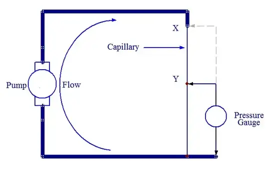

What's wrong with thinking of the water analogy? With a pump pushing water through a capillary, the pressure gauge below will see the full pressure at point X, but about half the pressure at point Y. The water doesn't 'know' what pressure to be at, it just encounters less resistance as it travels down the capillary and the pressure reduces in proportion.
(This is, incidently, how the bypass valve in a domestic central heating system controls the flow rate through the radiators).

  • While it may be correct, I don't find this analogy easier to understand then electricity. I think that it works to explain the principle, but more than that it only becomes confusing to me. – clabacchio Mar 29 '12 at 12:09
  • @clabacchio - I agree that some people like the analogy and some people don't - it is a matter of personal preference I suppose. I just thought I would point-out that the analogy still holds - even for potential dividers. – MikeJ-UK Mar 29 '12 at 12:24
