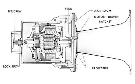

Another type of noise maker is the Siren which uses a different technique...
Most modern sirens use two concentric cylinders, which have slots parallel to their length. The inner cylinder is rotated by a motor while the outer one remains stationary. As air under pressure flows out of the slots of the inner cylinder and then escapes through the slots of the outer cylinder, the flow is periodically interrupted, creating a VERY LOUD tone.
Trevor_G
  • 46,364
  • 68
  • 151
    The diagram is of a klaxon rather than a siren. (Motor drives the ratchet which engages the stud, which vibrates the diaphragm) – peterG Feb 28 '17 at 13:36
