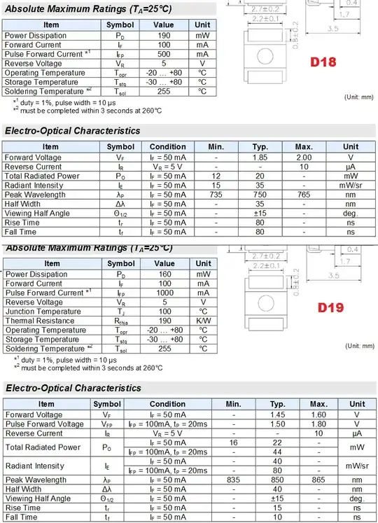

LED data

  • I added LED data to my post. Re suggestion 1: Note that boards are already made, thus this question - Assume I could find a P-channel FET with lower VGS, same package size and pin-out, would the circuit work with the LED and limiting resistor on the high side? This forum typically shows P-FET with load on low side. Suggestion 2: Won't increasing the pull up value reduce the voltage seen at the base of the FET? – JoeChiphead Feb 26 '17 at 17:00

  • I know that 100mA LED's are rated for ~ 300mW and this means ESR ~ 3 Ohms and MOSFET RdsOn ought to account for lower voltage drop. Typically << load ESR or i.e. <1Ω
