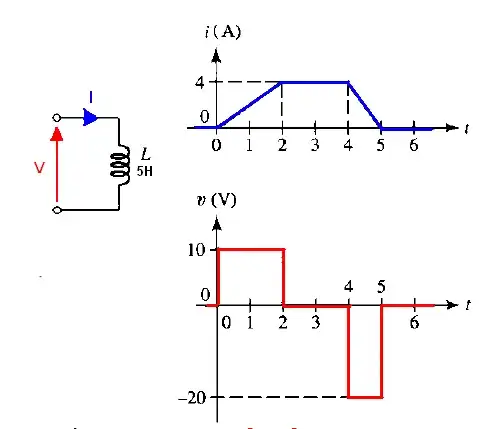

The voltage across an ideal inductor is \$V_L=L\dfrac{di}{dt}\$ or we can sometimes use this approximation \$ V_L = L*\frac{ΔI}{Δt}\$
This equation indicates that inductance voltage depends not on current which actually flows through the inductance, but on its rate of change.This means that to produce the voltage across an inductance, the applied current must change. If the current is kept constant, no voltage will be induced, no matter how large the current. Conversely, if it is found that the voltage across an inductance is zero this means that the current must be constant but not necessary zero. enter image description here
In summary: When the current is increasing di/dt > 0 The voltage across the coil VL must be positive because L times a positive number yields a positive voltage.
When the current is decreasing di/dt < 0, so V must be negative because L times a negative number yields a negative voltage.
When we have no change in current over time then we cant have any voltage V = L*di/dt = L * 0 = 0.
Knowing all of this, you can now use this V = L * dI/dt equation and this picture to better understanding Inductor AC behavior.

To know at which "phase" the inductor is we must look at the current. What the current is doing at a given moment. Inductor stores energy in form of magnetic field. And the inductor is fully charged when IL=I_max and VL = 0V. Discharging phase ends when IL = 0A and VL=V_max.
So, from 90 to 180 degrees the inductor current is rising and ends at IL_max. This must be the Charging Phase.
From 180 to 270 degrees we have Discharging Phase.
From 270 to 360 degrees we have a Charging Phase but in the opposit direction.
0 to 90 degrees we have a Discharging Phase.
We can also look at instantaneous power, the product of the instantaneous voltage and the instantaneous current.
The positive power means that we are "absorbing" power from the source(circuit), the charging phase.
Negative power means that the inductor is releasing power back to the source(circuit), discharging phase.

  • how can an inductor discharge its current at the very beginning of the cycle? – Perspicacious Feb 26 '17 at 04:41
  • @MritunJay Do not forget that all this figures and description show steady-state situation. They assume that the inductor was Turn-ON for a very long time before we start our analysis. Do you understand this ? – G36 Feb 26 '17 at 10:30
