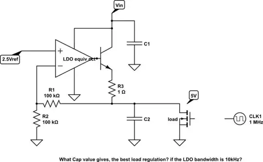

If you can analyze a pulse load noise response, you can choose your own Cap.
The LDO is internally compensated to be unity gain stable with a capacitive load. But step load response may cause under-overshoot depending on rate of steps. So choose Cout based on Ic=Cdv/dt for dv/dt= ripple and output ESR of emitter follower of about 1 Ohm without feedback (depending on current rating) and with feedback Zout is reduced by OA gain at DC and is implied by load regulation error in datasheet as the R ratio. Assume OA BW is about 10kHZ.
Does this help you understand?
