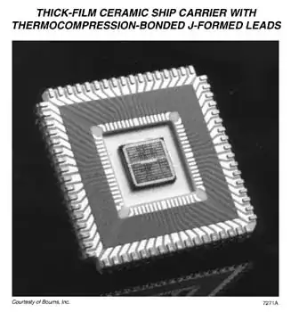

The black part: usually molded plastic, sometimes a ceramic material.
Some ICs can be bought in a CSP (Chip Scaled Package) which actually means no real package at all, on top of the chip a redistribution layer is made (which spaces the connections to what the PCB can use) and the IC is then mounted directly on the PCB. This technique is also called "flip chip".
