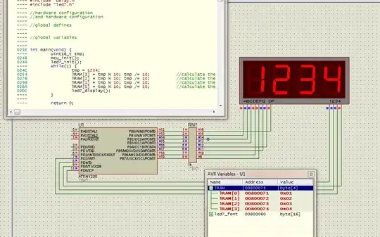

here is how it is doing in simulation - displaying a fixed number of 12 -> only '2' is being displayed because of multiplexing.
I didn't run the led_display() in a timer isr for simplicity here but in a real project, it should.
as you can see, the code is immensely portable: there is no way you can tell if the code runs on a particular mcu. as a matter of fact, the code originally ran on a 8-bit PIC and I changed it slightly to run on a 32-bit ARM7.
on an 8-bit PIC, the code compiles to about 100 bytes with XC8 in free mode.
edit 2: here is the same code running on a low attiny2313 displaying a number 2313.
the code allows arbitrary connection of the mcu pins to led pins so great for the layout guys.
and to the extent there are unused pins on a port, their operations are un-hindered by the code - ie you can use them for something else.
all the user does is to include the .h/.c files in the project, specify the connection, and fill the display buffer lRAM[] with the numbers to be displayed and the module does its own things, fire-and-forget.
oh, the code supports both common anode and common cathod leds: the leds in the lpc2106 is a common cathod type and the ones in the attiny simulation is a common anode type.

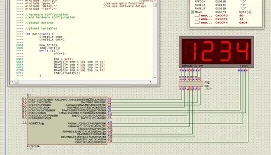

edit 3:
the prior led driver allows arbitrary assignment of led pins to mcu pins, as long as they are on the same port.
here is a revised version where led pins can be connected to totally different pins on different ports - completely arbitrary.
it follows the same process as the driver earlier. here is the simulation where it runs on a pic16f1936 driving a common anode led display.
