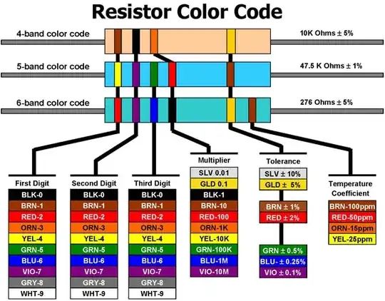

I asked a similar question a long time ago here but the resistor chart which was mentioned there appears to have moved. So from its new home at itll.colorado.edu here's the diagram, as far as I can tell one band will be thicker signifying it as the tolerance band (no-one responded when I queried whether this was the case in the previous post above so if I'm wrong please let me know).
Resistor Chart

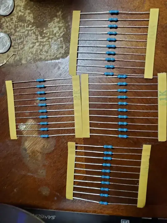

enter image description hereAfter hours of painstaking work of trying to figure out exactly how wide the gaps are on either end, I noticed there was a light print on the package which held the resistors together. That had the Ohms printed.
For some of you, this might save a lot of time.
