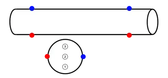

Bullet is shot into plastic pipe with diameter of 32mm. I've tried to put on one side IR LED and on the other side phototransistor (BPW 40), both at the start and end of the tube. Something like this:
Blue circles are phototransistors, red circles are IR LEDs and white circles are airsoft bullets.
When bullet passes through area where bullet 2 is drawn (just in between IR LED and phototransistor), everyting works perfectly. But when the bullet passes where bullets 1 and 3 are drawn, it isn't detected. That is expected, but unwanted behavior.
So my question is: how can I detect bullets regardlessly of it's position ? I've thought about putting IR LEDs and phototransistors around the pipe (not only in one place), like this:
but this solution isn't cheapest: 5 IR LEDs + 5 BPW 40 = cca $12 times 2 (because I need it on both sides of the pipe) = $24. Is there any cheaper solution ? Is BPW 40 good choice for phototransistor ? I don't know which IR LEDs I'm using (and salesman in the store also doesn't know - he told me these are generic ones for remote controllers, like TV or DVD controller).
Diameter of the pipe is 32mm and it will be long about 14cm (sensors will be 10cm apart). Diameter of airsoft bullet is 6mm.

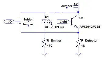

Edit #2: Schematic for proposed design
I used an ATtiny40 in this design, there are a variety of controllers which could be used. Sorry for the mess of nets around the outside, I'm trying out a neat new online editor (click the image to open it) which doesn't yet have busses.

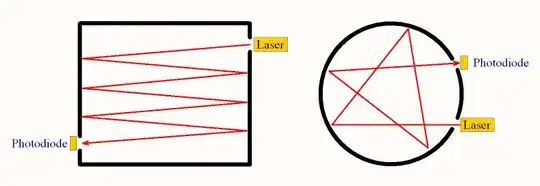

One method which might end up cheaper and simpler is to use a laser. As Kevin said, it's easier to make a light curtain in a rectangular tube than in a round one. Make the insides of the tube reflective, either by gluing mirrors inside, or by super polishing them. Then aim a laser through a hole in the tube so that it bounces around multiple times before hitting the phototransistor. As long as there are no holes big enough for the ball the pass through, then you're guaranteed to detect it (You might need more bounces in the circular case than I've drawn).
Laser light curtains

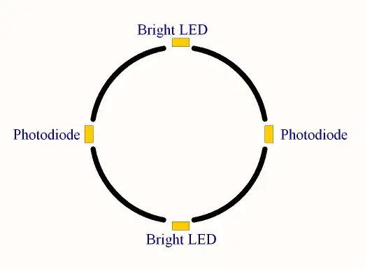

Another sensing method, which is closer to what you're using now is to invert things. Rather than the LEDs shining on the phototransistors, and the ball cutting out the signal, why not arrange it so that the phototransistors detect light reflected from the ball?
Arrange the LEDs so that there is no light shining on the phototransistors. Make the LEDs very bright. When the ball passes the LEDs, it glows brightly under the illunination, and a small signal is detected at the phototransistors.
Detecting by reflection
