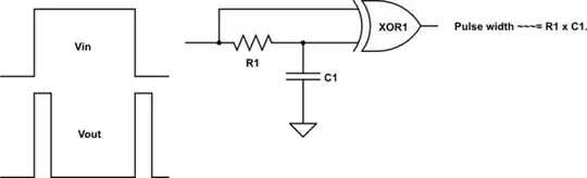

  • See my XOR gate addition. You can get very small package single gate XOR ICs that will do what you want. Non operating current drain can be a few microamps. – Russell McMahon Feb 26 '17 at 23:39

An XOR (Exclusive OR) gate (or XNOR) can be used to produce an output pulse on the rising or falling edges of an input signal. An XOR 'truth table' is:
IN Out
00 0
01 1
10 1
11 0
ie - the output is high when one only input is high. Both inputs low or both inputs high produce a low output.
In the diagram below the RC combination acts as a delay that causes any input level change to be delayed in arrival time at the RC connected input relative to the directly connected input. When a continuous high or low is input, both XOR inputs are the same polarity and output is low.
When the input level transitions there is a period of about t = R1 x C1 when the two inputs are not the same and an output pulse is produced.
Ideally Schmitt triggered inputs would be used, but std inputs "work OK" - subject to there being no input transients.
The RC only consume energy when the capacitor charges or discharges and this can be very small so the circuit achieves extremely low power consumption. CMOS gates when not switching draw sub microamp currents.
You can get single XOR gates in a package so small it's almost a breathing hazard. One of many is 74AHCT1G86SE-7

  • Russell, the suggestion with the XOR gate is great! Since I need Vout inverted I supposed I could use a NOT gate after the XOR, but then I realized that a XNOR gate work. If so, this is a very simple solution. I will also look at creating this as a Schmitt trigger, although I think if I size the pulse T (e.g. R x C) to 150ms then it should "debounce" itself. Again, great suggestion...thanks! – Mark Stevens Feb 28 '17 at 02:42
