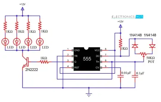

I believe the best solution (which I am using and grabbed from https://www.electronicshub.org/pwm-led-dimmer-using-ne555/) is to use the first circuit (in the OP) but use diodes on the potentiometer in order to allow the duty cycle to vary from near 0% to near 100%.
The load shown is LEDs (with current-limiting resistors), IOW, a dimmer for the LEDs.
I am using a Darlington BJT device (http://www.mouser.com/ds/2/149/KSD560-63636.pdf) because I'm going to want to control quite large loads (several amps) so the much higher DC current gain of the Darlington configuration is good.
Looking at the datasheet for the LM555, note that the high-level output is guaranteed to only be 3v or so (for Vdd=5v), which probably precludes using a power MOSFET (most of which don't guarantee Vgs-threshold to be below 3v). But the DC current gain of the Darlington is so high that it almost looks like a MOSFET, except drops a little more voltage (from collector to emitter, versus from drain to source).
I'm using this as a dimmer also. A big issue I ran across is that the LED bulbs I'm using have a capacitor in them. If the PWM frequency is too high, that waveform is filtered out and you can't dim very low. But if you lower the PWM frequency too much (by increasing the size of the capacitor on pin 6 or the resistance of the potentiometer) then you'll get flickering; so it's a compromise.
RustyShackleford
  • Does the range of selectable duty cycle depend on the relationship between 1k and 50k pot? If so exactly what is the formula for optimizing or at least determining range given selected components. – Andyz Smith Jul 01 '20 at 23:19
