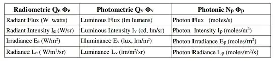

The above 4 measurements relate only to Photometric units of measure.
The three basic units of light measurement are:
  1. Photometric (photometry)
  2. Radiometric (radiometry)
  3. Photonic (quantum)
Radiometry is the study of optical radiation of light, ultraviolet radiation, and infrared radiation. Radiometric is a measurement of the actual flux emitted from the light source.
Photonics measures light as quantum particles called photons. Photons are elementary particles of light which carry light's electromagnetic force. Photons, travel in straight lines at the speed of light, and carry a fixed amount of energy. Photons have two distinguishing characteristics, direction and wavelength. Photons are a quantum measurement of light particle energy measured in the quantity of photons per second. Typically measured with some sort of photon detector which counts the number of photons that hit the detector's surface within a period of time.
Photometry, is about human optical visual response to light (luminous spectral response). Photometric is a measurement of the flux emitted from the light source and then adjusted for its sensitivity to the human eye. Photometric measurements only includes light visible to humans. The human eye is most sensitive to green at a wavelength of 555nm (Lime Green) as determined by the CIE (International Commission on Illumination). This 555nm wavelength is the international photometric standard to which all other wavelengths are compared.
This sums it up, almost
measurement of light quantities
Then there are the official SI Units of Measure
SI optical units of measure

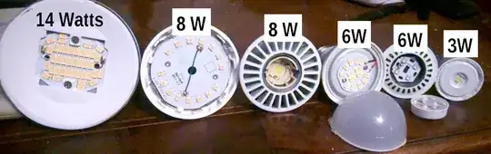

LED Light Bulbs No Cover
That brings up another Question, Why are these LED Light Bulbs Made Like This?
