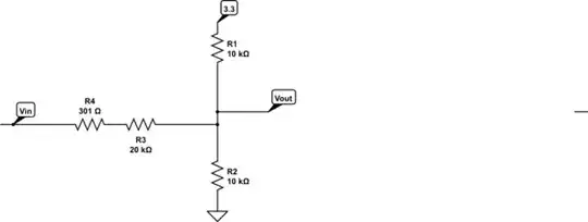

This circuit would be perfect (Output: 0-3,33V), but I have only 3,3V source (from MCU) and I made another circuit (in which I have output: 0,04-2,83V):
What should I change in second circuit to have output (0-3,3V) like in first circuit? Maybe voltage stabilizer diode or op-amp?

For those who would searching the same info to their project:
I chose first circuit from this post.
I changed R11 to 110K and R12 to 22K,
In place of 2V source I put 2V voltage stabilizer (Sanyo LA5002) (between the 3.3V MCU output and R11). And it work great :)
