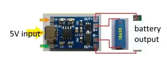

Solution A
Use only a 1S3P (or more in parallel) pack instead and use a TP4056-based USB 5 V charger. Pairing with 3 BOOST converters to power the LCD, PS2 and other electronics at their own voltages, WITH a 1S BMS. (My worry is that my battery may not be able to handle the current draw.)
I'm aware that I'll have to do calculations based on the efficiency of the boost converters as well, to get an accurate current draw from the batteries.

  • Solution A is easy, safe (provided that you have enough batteries in parallel) and workable, but you need a beefy boost converter, and it will not be the most power efficient.

Solution A - Use only a 1S3P (or more in parallel) Pack instead and use a TP4056-based USB 5V Charger.
Bad idea. The battery will charge very slowly, and the booster will waste power. The pack and wiring will have to handle 14A+ discharge current.

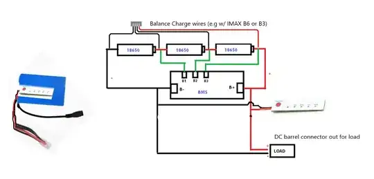

Perhaps the best solution could be combining the use of the protection board and incorporating a set of balance charge wires in the battery pack itself.
This approach would protect the cells on discharge via the protection circuit (cheap 3s "BMS") while also relying on the external balance charger (e.g. IMAX B6 or B3) to properly balance charge the cells. Overdischarge protection offered via the protection board would never be used if going this route, since you would only be charging via the balance charge wires and external balance charger.
If you were really in a pinch and were without your balance charger, I suppose you could plug in a 12.6 V charger to the DC-in, but 99.99-100% of the time, it would think it would be better to charge via the balance charge wires.

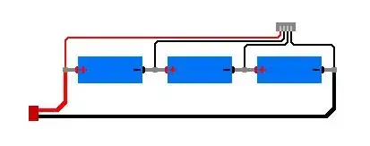

Balance charging wiring
As a follow-up to my previous response diagramming the wiring of the balance leads in addition to the protection circuit, I found a DIY video on YouTube showing the exact configuration be put into action for a 3s li-ion pack. See approximately 4:30 into the following video for the build instructions: https://www.youtube.com/watch?v=hwhqn4BmC2I
