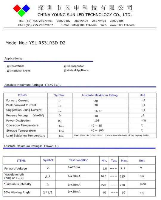

An LED should have a data sheet that describes the LED's electrical characteristics and tolerances. For example see this data sheet Model No.: YSL-R531R3D-D2.
The first characteristics we are interested in is (1) what is the maximum current that the LED can sustain before material failure is possible resulting in LED failure and (2) what is the recommended current range. These and other Maximum Ratings for a typical standard red LED (different LEDs will have different values) are in a table as duplicated below.
screen shot of standard red LED data sheet
In the table from the data sheet for this standard red LED we see that the maximum current is 20mA with the recommended range being 16mA to 18mA. This recommended range is the current for the LED to be at its brightest while not risking material failure. We also see that the rated Power Dissipation is 105mW. We want to make sure that in our LED circuit design we stay within these recommended ranges.
Looking in the next table we find a Forward Voltage value for the LED of 2.2v. The Forward Voltage value is the voltage drop when current is flowing through the LED in the forward direction, from anode to cathode. See What is “forward” and “reverse” voltage when working with diodes?.
If we were to use this LED in a circuit with 2.2v and a current of 20mA then the LED will dissipate 44mW which is well within our power dissipation safety zone. If the current changes from 20mA to 100mA the dissipation will be 5 times greater or 220mW which is well above the rated 105mW Power Dissipation for the LED so we could expect the LED to fail. See What happens to my LED when I supply too much current?.
To reduce the current through the LED to the recommended levels, we will introduce a resistor into the circuit. What value resistor should we use?
We calculate a resistor value using Ohms Law, V = I x R. However we will make an algebraic transformation because we want to solve for Resistance rather than Voltage so we instead use the formula R = V / I.
The value for I, current in amperes, is fairly obvious, lets just use the recommended minimum of 16mA or .016A from the LED data sheet in the transformed formula. But what value should we use for volts, V?
We need to use the resistor's voltage drop which is the contribution the resistor makes to the total voltage drop of the entire circuit. So we will need to subtract the voltage drop contribution of the LED from the total circuit voltage to determine the voltage drop contribution needed from the resistor. The voltage drop of an LED is the forward voltage value, the voltage drop in a forward direction from anode to cathode, from the table above.
For a standard Raspberry Pi project using the 3.3v rail as a power source, the calculation would be (3.3v - 2.2v) / .016A = 69 ohms (rounding 68.75 up)
