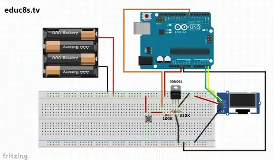

I have tried to implement the following circuit: http://educ8s.tv/auto-power-off-arduino-simple-circuit/ which is using one N-channel MOSFET to disconnect the negative lead of the battery.
Circuit 1
(source: educ8s.tv)
The result is that the uC is using the Drain as its ground. If I want to send "low" from the uC to the Gate I get strange results that I don't understand and the MOSFET conducts. The only time it doesn't conduct is when Gate is pulled down to battery ground (Source) and not connected to anything else.

  • Switching the positive power lead has less chance of unintended consequences. My suggestion is to go with the 3rd diagram with 2 FETs. In any implementation, choose the FET for the correct operating conditions. For this in particular, look in the datasheets for the charts of Vds vs Id with Vgs, make sure at the Vgs the circuit provides, Id and Vds are at an acceptable conditions. For example, for the 30N06L, for voltage of around 3.3V, it probably wouldn't work as intended and of 5V would be marginal. – rioraxe Feb 01 '17 at 18:59

Switching the high side (positive power lead) with a N-ch transistor
Vd will be Vbat and Vs=Vout will be close to Vbat (Vbat-Vds) but normally much higher than Vgnd. To open a MOSFET Vgs needs to be more than Vs+Vth=Vout+Vth (where Vth is a threshold that depends on the specific MOSFET). As a result Vgs needs to be higher than Vout, so the load can't hold it open unless it has a second, higher voltage rail it can control. This is a big downside. Reference article.
Switching the low side (negative power lead) with a N-ch transistor
Vd=Vout- and Vs=Vgnd however due to drop Vds, Vout->Vgnd so the load and the disconnect circuit don't have a common ground. In order the open the MOSFET, the uC will need to send voltage that is less than Vs+Vth=Vth, but it can only send Vout>Vgnd. Depending on the load, the MOSFET and the resistors used one can tune the circuit to drop Vout below Vth but it was shown in practice that the result gets too specific for a certain specific circuit and uC. Very easy to get unexpected consequences with the schematic due to lack of common ground. This is a downside. Case study, Discussion
