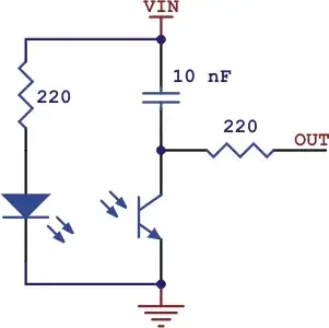

Note that there are two models of sensor available - the QTR-8RC module which output a pulse
and the QTR-8A module which outputs a DC level.
You say you have the ...RC module.
The code for RC & 8A modules is not interchangeable so double checking what you have would be wise.
The Polulu reflectance sensor:
8A model at left, RC model at right.
