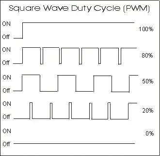

Lets look at your PWM outputs. Depending on the duty cycle, or how long the pulse is "high" compared to "low", an average level can be achieved.
You can keep this chart in mind as you are following along:
PWM cycle comparisons
If at 50% duty cycle and you can somehow chop a 5V waveform to fill in the hole you will have roughly 2.5V. You can use a simple RC filter for this:

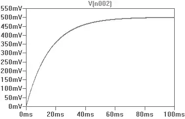

Simulation:
An LTspice (free) simulation assuming 100MHz PWM just for this example with 10% duty cycle, 15.8k resistor, and 1uF capacitor:
(cutoff = \$\frac{1}{2\pi RC} =\$ 10Hz)
LTspice simulation of RC filter for PWM
The graph will show:
  • It will take roughly 100ms to steady
  • The result is 10% of 5, or 500mV (as expected)
  • Noise appears to be at a minimum (~5mV peak-to-peak)
In practise you will have defects and more variables to worry about and will be worse than this somewhat, while following the general curve.
