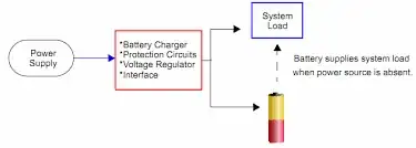

I don't know whether this is a 100% perfect solution as per my requirement or not but seems to be working good and very much similar to the solution I was looking for.
Solution is Load sharing: charging the battery and have the main circuit run normally enter image description here
We can use any charge controller ic I am considering here is MCP73831 because of low cost and good features and 5-Pin SOT-23 package, just simple to use.
  • When USB power is applied this circuit will turn off Q1(P channel MOSFET), and as long as (Vusb – D1 VF) > (Vbat – Q1 VSD) then the load will instead use power from USB through D1.
  • When USB power is applied Q1 will turn off and stop current flowing from the battery to the load, effectively disconnecting the battery. The load will then use power from USB through D1.
  • The time USB power disconnected, Q1 will turn on and battery will get connected to load.

I would post this as a comment to your own answer, but I can't because I don't have 50 rep...
Anyway, your circuit will technically work for what you're trying to do in that your load will be powered from USB. It seems as though your PFET drain and source terminals should be switched. Right now, your load is being powered by USB only because of the inherent diode from drain to source in your PFET, not because you've gone out of the Vgs threshold as you expect.
Switching your PFET drain and source will indeed cause your circuit to perform as expected.
EDIT: DON'T SWITCH THE SOURCE AND DRAIN. The reason they are oriented the way they are in OP's answer is so that the inherent diode in the FET is used as a blocking diode to protect the battery and avoid shorts. In the case of Lithium batteries, the USB voltage (5V) will always be higher than the voltage of the battery (~4.2V max). If the drain and source are reversed as I have previously suggested, the USB input voltage will be shorted with the battery through the inherent diode. Sorry for any confusion.
