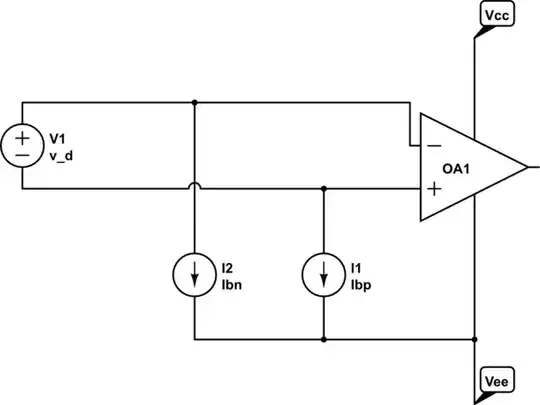

The input bias currents behave as below, where I1 and I2 are the respective input bias currents and I2-I1 is the input offset current.
The op-amp will only operate properly if the inputs are within a given common mode range (with respect to Vcc and Vee). That might be very close to the supplies or it might be a volt or two away from either or both supply.
As you can see in your right-hand example, there is no path for I1+I2, so the inputs will rapidly approach the supply rail (at which point the current sources stop being more-or-less ideal).
It's possible that some op-amps under some conditions might happen to sort-of work but it's not something you should rely upon. Always provide a DC path for both inverting and non-inverting inputs. The above example provides a path for only the offset current (I2-I1). The total bias current (I1 + I2) has no path.
As to what exactly the output would be- you can think of it as Avv_d(Vcc+Vee)/2, though the offset voltage of the op-amp times the gain is usually enough to saturate the output at either rail, so the mid-rail adder (Vcc+Vee)/2 is sort of arbitrary. Hopefully that makes sense to you.

  • Hi Spehro Pefhany, I can't understand what "*The above example provides a path for only the offset current (I2-I1)*" means. IMO the offset current is not another current but the difference between the magnitudes of the two input currents. So no any current flows in the picture on the right. – Circuit fantasist Feb 08 '23 at 08:16
  • @Circuitfantasist If one current was +1nA and the other -1nA (not impossible for a CMOS-input op-amp) 1nA current would flow through the voltage source. The net bias current is zero in this case. Since the bias currents vary with input voltage this is not totally outlandish. – Spehro Pefhany Feb 08 '23 at 09:34
  • Maybe I'm missing something. According to my understanding, current cannot flow through the floating input source because it would have to come out of one input, pass through the source, and enter the other input. But currents can be only incoming (NPN transistors) or only outgoing (PNP transistors). – Circuit fantasist Feb 08 '23 at 11:20
    @Circuitfantasist In the case of a CMOS-input op-amp the current will only be leakage and it could be of either polarity on each input. If you allow one input to float it will drift to some voltage between the rails. If you connect the two inputs together then they will, in general, float to a different voltage with some tiny current flowing between the inputs. The generality of PNP and NPN current directions applies within the CM input range, but.. – Spehro Pefhany Feb 08 '23 at 12:25
    I agree and have thought so regarding FETs. But here I was guided by the view that the input bias currents are created by the current source in the emitters and the offset current represents the difference between them. Thanks! – Circuit fantasist Feb 08 '23 at 13:18

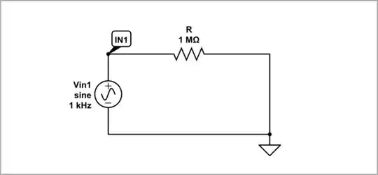

Floating source and input
This is the simplest way to connect a voltage source to the device's input without using the concept of ground. For this we need two connecting wires.
Grounded source and input
In electrical circuits, however, we use a clever trick - we connect one end of all elements (input source, feedback network, output, load, etc.) to a common wire that we call "ground" (as they say, "the input voltage source and device's input are single ended"). In this way, we connect the device's stages with only one wire and talk about "voltage at a given point". This connection technique is widely used in cars where the body serves as a ground.
Notice that the devices are still connected by two wires, only one of the wires is common to all devices. This also leads to some limitations in connection - devices cannot be connected in series (to be "floating"); they can only be cascaded in a parallel manner.

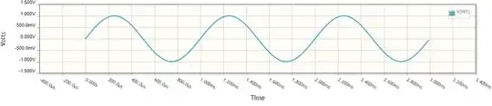

Right-grounded source and input
Thus, if we ground the right terminals of both source and resistor from the figure above, we can drive the resistor from the left.
simulate this circuit
Fig. 2 - graphics

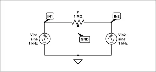

Above we drove a grounded device input by a grounded input voltage source. But what do we do if the input is floating and we still want to drive it with a grounded input source? How do we drive a floating input with a grounded source?
Conceptual circuit
We can apply another clever trick - we can "split" the floating source in the first figure above and ground the midpoint between the two "sub-sources".
Thus we arrive at the idea of ​​differential input - to drive the input simultaneously on both sides using two grounded (single-ended) voltage sources. Actually, they are connected (through the ground) in series; so their voltages are summed (subtracted) according to KVL and the total voltage is applied to the resistor as in the first picture.
Let's implement this arrangement but now with the help of a slightly unusual "resistor" - a potentiometer. It is the same resistor as the one above, only with the help of its wiper we can observe the voltage at any point inside it.

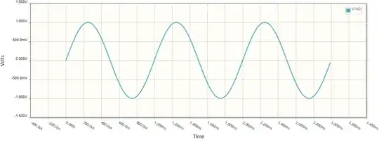

I have set an offset (input common-mode) voltage of 5 V and AC (differential) voltage of 100 mV. The phase of Vin2 is 180° (inverted). The output common mode voltage is 9 V.
