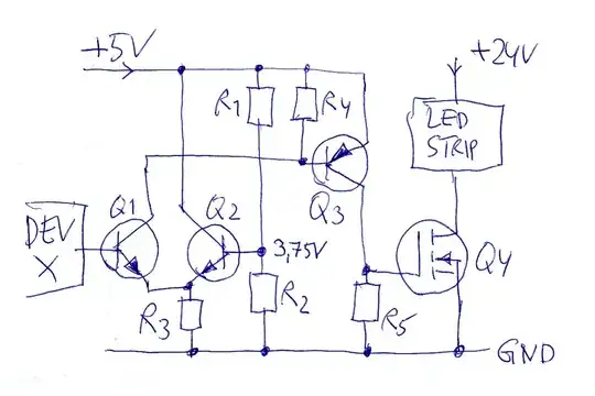

At first check; Is it really +5V =high +2,5V=low.
Assuming yes: Use a comparator that outputs 0V or +5V directly to the gate of the mosfet. Comparator tests, if device X outputs more than 3,75 V. If yes, then give +5V to mosfet's gate.
A proper comparator that operates from single +5V supply, can produce 0V and +5V output levels and can sense properly +5V is tricky. Here it is as a discrete part implementation
Parts must calculated starting from the end
  • R5 must pull the gate down fast enough
  • Q3 must push enough collector current to lift the gate near +5V
  • Q3's base current = the collector current/hfe
  • for reasonable turn off speed, R4 must take at 0,7 V at least as much as Q3 needs base current; that is R4 < or = (0,7V/ Q3's base current)
  • Ri and R2 produce the treshold 3,75 V to Q2
  • R3 gets about +3,05 V. R3 = 3,05 V/(Q3's base current + 0,7 V/R4)
  • the 3,75 V reference should not teeter. Let (R1 parallel R2) to be five times R3 or less. Add a capacitor parallel with R2, if needed.
  • solve R1 and R2 from the wanted voltage and max parallelled resistance.
At first take Q1 = Q2 = 2N1711, Q3 = 2N2905. 2N3704 and 2N3904 should be ok, too.
Simulate before building a prototype
  • Thanks for this elaborate solution. What would be the advantage of this circuit over the simple "grounded base" configuration? (See one of other answers.) And yes, the pin I probed is really 2,5 to 5 V and has the biggest amplitude, compared to other pins I probed. All started at 2,5 V or more. – empewoow Jan 25 '17 at 15:05
  • @empewoow Check at first, if something pulls your signal up; it is: Already a too low Ohm resistor or other part is connected between your output and the +5V. Answer: This solution can be faster because as much current as needed for fast mosfet switching can be pushed and pulled to/from the gate. The simple version is limited to how much your device X can push out. But if its speed is enough, use the simple version. NOTE: The simple version does the same for the mosfet than Q1 in my version does for Q3. In both cases the controlling voltage is compared to the reference by a comparator circuit. –  Jan 25 '17 at 15:34
  • @empewoow (continued) Check also, if the output in dev X needs a pulldown resistor that still is not connected. About he speed: if you blink the leds at few hundred Hz, the simple solution might be fully usable. Simulate it first and see how long the transitions take when compared to the switching period.Those transition times should be max. a few percent ot the period. –  Jan 25 '17 at 15:52
