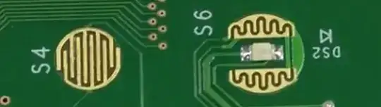

Is it possible to use a PCB pad as a button? I think of using it to switch on a curcuit that is only supposed to be enabled, when the user holds it in its hands.
As inspiration, I used the pads that are being used on soft touch buttons on keyboards or in calculators:
I know that the human body has a quite high resistance, so what would be an appropriate circuit to detect the touch input? Bare hardware only. I don't want to use any microcontroller here.

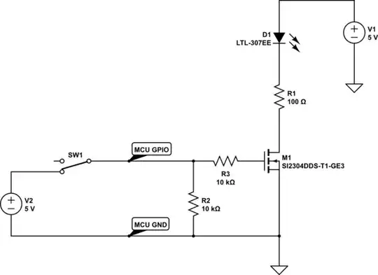

For reliability reasons I wouldn't go for an open-gate design and rely on the 50Hz noise. It probably might work, but your idea of using interleaved fingers should work quite well.
The resistance of dry skin is somewhere between 1k and 100k, so you could think of an NMOS transistor (find one with ESD protection) and a large pull down of e.g. 1M ohm. Then you can use the finger as a pull-up resistor to turn on the mosfet.
You could also use a bipolar (or darlington) transistor, they are less vulnerable to ESD defects, but cannot supply a large current at the output if needed so you would need to buffer the output.
A capacitive sensor would be an alternative solution, but requires a more complicated circuit.

    I would consider adding a 10k resistor between the cathode of D1 and the junction between R1 and the right-hand side of the sensor to limit the instantaneous current into the gate of M1 from a static discharge and help D1 do its work by generally slowing fast edges down. If you find this circuit particularly noise-prone, a 100pF or so capacitor across R1 may help that - you'll have to build it and try it out! – stefandz Jan 23 '17 at 12:13
  • Good point, I'll add it to the circuit diagram – Douwe66 Jan 23 '17 at 12:14

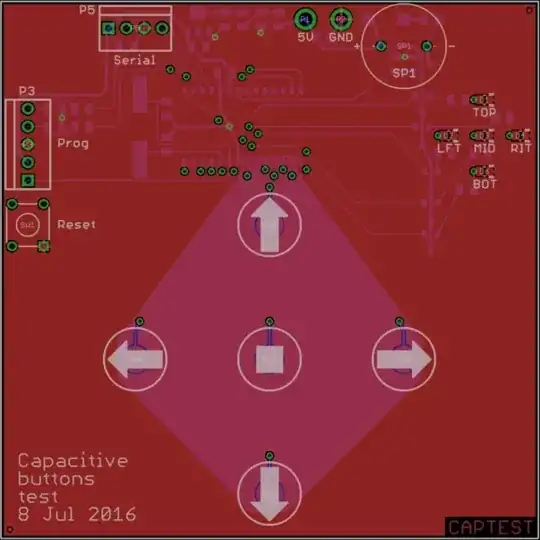

Here is the layout of a small board I did recently just to research capacitive buttons:
The cap pads are small disks 150 mils (3.8 mm) in diameter and otherwise surrounded by ground on the top layer. The microcontroller is a PIC 16LF1786. It and all the other parts that aren't for directly interfacing with the user are mounted on the bottom of this two-layer board.
The PIC continually scans the pads. When it detects a change in the pressed/released sense of a pad, it sends a message over the serial port, updates the lights at top right, and emits a beep on a press.

  • What are the units of the `Y` axis in your plot? Are pads simply connected to the pins, or are there other components involved? – Dmitry Grigoryev Jan 23 '17 at 15:07
    @Dmitry: The Y axis shows the internal "how much the button is being touched" measure. It is derived from raw A/D values, but there are multiple A/D readings envolved, and there is significant processing on those readings. There was no attempt to keep them in particular units, since these values are relative to each other and arbitrarily entered thresholds. Very roughly they are in units of about 800 uV differential between reading. 350 means about 280 mV, but again, it's not really that simple. – Olin Lathrop Jan 23 '17 at 15:34
  • So you're driving the pads high and low, and measure some sort of charge/discharge rate using ADC? – Dmitry Grigoryev Jan 23 '17 at 15:42
    @Dmitry: I'm driving the something else high and low, then measuring the step change in the pads. Nothing is time-based other then allowing enough settling time to take readings. – Olin Lathrop Jan 23 '17 at 16:00
