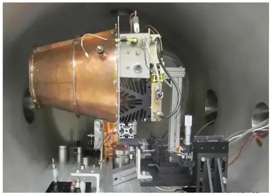

above: "Fig. 14 Forward thrust mounting configuration (heat sink is black finned item between test article and amplifier)." from here
above: "Fig. 17 Null thrust mounting configuration, b) view from side" from here

    If the Q is so high and the output thrust (and presumably power) so low then why is there a bloody great big heatsink on the end of the copper bucket? Where is all the power going? – Andy aka Jan 24 '17 at 13:59
    @Andyaka That looks like a lovely heatsink to use where there's convection going on. Shame they're using it in a vacuum. – Andrew Morton Jan 24 '17 at 20:03
  • @Andyaka I think the heatsink is on the drive electronics, not the resonator. Quite what it does in a vacuum is another matter! –  Jan 25 '17 at 10:53

The design in the picture looks like it might have been limited by microphonics, and then reworked to eliminate them. For example, it uses a large heatsink instead of a fan. It also looks like alignment would be a real chore!

  • **note:** in this application the cavity and RF source are sitting on top of a very sensitive balance, and micro-Newton forces are being inferred, so I think a fan would be excluded from the beginning. Consider also the title of the paper: "Measurement of Impulsive Thrust from a Closed Radio-Frequency Cavity *in Vacuum*" – uhoh Jan 25 '17 at 10:52
