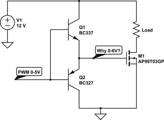

Method A: NPN+PNP (Voltage-follower? current sourcing from Vcc?)
I made the following circuit, not realizing that the gate voltage would never be more than the input signal voltage.
I need the gate voltage to be more than 10V to minimize Rdson.

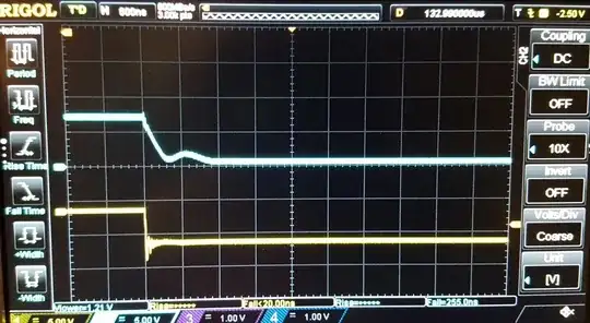

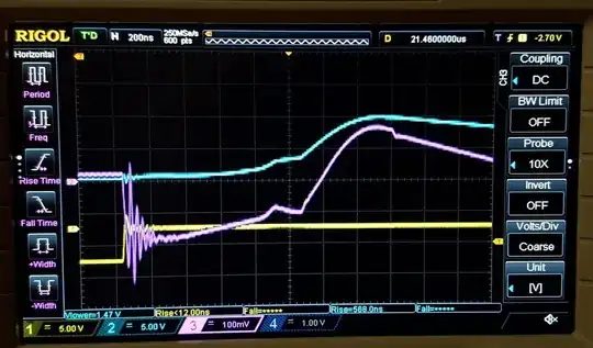

Oscilloscope:
Note: apparently the input signal was inverted on the oscilloscope by setting. I'll update the screenshots later...
enter image description here enter image description here enter image description here
Also, I've included the base of the PNP in the following screenshots. Is it supposed to look like this? It looks a bit funky.
It seems the problem is that the NPN stays switched on, thus preventing the gate from charging.

    Still needs improving. Q2 is hevily overdriven. =>> enormous turn off delay (=storage time). Nothing has been done against the overdriving. In the past those countermeasures were well known, but they seem today been left among the dust. Secondly: Q1 pushes continuously and Q2 has a hard job to win it. Probably the minimum Vgs is around 0,3 V. You should use the 0V/5V PWM output thru a nonsaturating buffer amp that can inject and pull out enough charge from mosfet's gate during wanted state transition times. Want to know more? Please write a comment . Refer my answer. –  Jan 21 '17 at 02:06
  • What could I use to reduce overdriving? I tried with a few diodes and it seems to help mainly with the delay, but didn't affect the fall time. And the PNP doesn't seem to work as expected. Is it possible that 12V flows through the PNP and raises the signal voltage, and then flows down through the NPN? – user95482301 Jan 21 '17 at 20:40

Your BJTs are in a follower configuration. This means that they can provide current gain, but not voltage gain. In fact the emitters will be a diode drop BELOW the base for positive going signals. If you got to 6V on the gate you must have had around 6.7V out of your signal generator.
The BJT Wiki page has links to the 3 common forms of amplifier which explains more about the characteristics of BJT amplifiers.
BJT Wiki
The current gain is a good thing because in order to charge the gate capacitance of the FET in a short period of time you need high peak currents: I=C*dv/dt.
One way to get a higher voltage swing would be to add a BJT level shifter before your gate drive stage to translate from 5V to 12V. Of course a single stage BJT level shifter would invert the signal, but often you can deal with that at the signal source.
The pull-up resistor will have to be sufficiently small in value so that you get an acceptable rise time for your application. VCC would be your 12V supply and the base resistor should be sized to guarantee saturation with the 5V drive, given the beta of the transistor. !Y should connect to the bases of your BJT gate driver stage.
However, if your goal is fast rise and fall times from the FET and not learning about BJTs, you should probably use a commercial gate driver IC. Look for options from IR/Infineon, Texas Instruments, Intersil or Maxim.

The first version - a push-pull emitter follower should be fine if only the max available mosfet VGS = +4,3 V is enough. The pulldown resistor about 100 Ohm should be inserted from BJT emitters to GND to ensure mosfet's off-state, because the PNP does not pull down effectively under +0,7 V. Additionally a few Ohm damping resistor inserted just into mosfet's gate terminal should prevent some ringing caused by capacitance and wire inductance.
Your second version has a shortcut. Think about the current route Q2 base->R3->R2->Q1 base.
Emitter follower has no saturation and thus no turn off delay due the diffusion capacitance.

< why 0-6v?
Q2's emitter is 0.7v above Q2's base, which is 0-5v. That's your answer.
