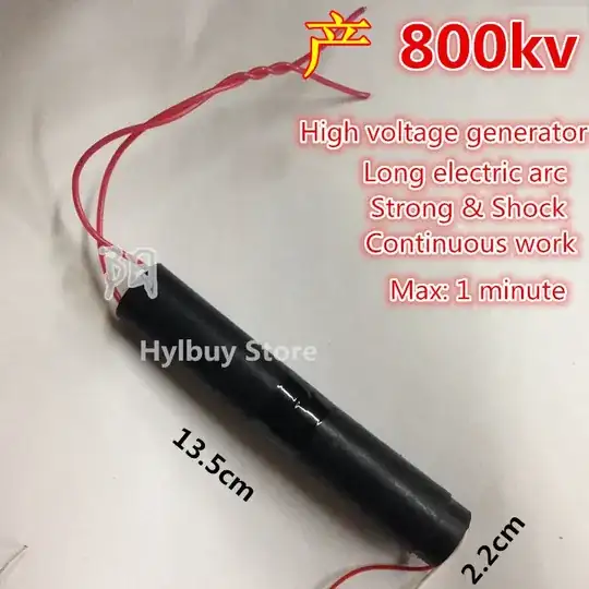

I am trying to create an arc generator and I have read about the marx generator but I am looking into more compact modules like the image below. All the ones I have found seem to be fake and actually supply less than 1/10th of what they are advertising.
Boost converter Is there any reliable way of generating a (non-continuous) super high voltage arc?

    If say you wanted to get 1mA out at 800kV, that would require over 100A at 6V. I've got 30kV out of a flyback transformer from a 24V supply before pulling a more reasonable 6A. – Tom Carpenter Jan 15 '17 at 14:58
  • Since science allows it, so it's possible. Question is, is it "feasible"? If so, what's the design look like, if not, how high have been achieved? – user3528438 Jan 15 '17 at 15:05
    @TomCarpenter How do all the stun gun brands advertise bizarre voltages like 1MV? Are they just like 5A-6V to 30µA-1MV? – stenlan Jan 15 '17 at 15:05
    They might be saying that the field strength is 1 mega volt when they mean 1 mega volt per metre. They may have conveniently forgotten to state the per metre part just like internet providers annoyingly leave off the per second part when quoting data rates. – Andy aka Jan 15 '17 at 17:55
    That one in the photo- maybe 10-20kV. 800kV would initiate an arc over maybe 8" (200mm). It would also likely be a rather poor impedance match to human flesh (and thus ineffective) if it's a stun gun. A Taser open circuit is ~50kV perhaps but when delivering a shock the voltage drops to ~1.2kV. – Spehro Pefhany Jan 15 '17 at 20:38

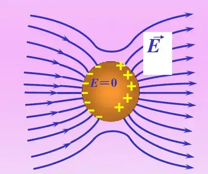

From my high-voltage class I remember that the maximum field strength is about 30 kV per centimeter. And this is for a homogenous electrical field, e.g. between large spherical conductors, where the conductor diameter is large compared to the gap distance.
Hence, for 800 kV you need an air gap of at least 25 cm, between spherical conductors with a radius of, say, over 1 meter. Just google at "high voltage lab" and you will see such spheres. The Vandergraaf Generator, sketched in another answer, has such a sphere, and its diameter and distance to Earth limits its top voltage.
Looking at your picture with thin wires expecting to carry 800 kV, I do not see a homogeneous field, and the distance between the conductors is in the range of millimeters. If you charge up those wires, you will get sparking long before you reach 30 kV. Not only sparking at the end of the conductors, through air, but also through the plastic insulation.
For illustrations about the difference between conductor shapes, search for Rogowski Profile or Electrode, e.g. here
So the question is not how to transform a low voltage to a high voltage, but how to prevent sparking.
The stun guns and tasers that advertise 1MV may be able to reach 1MV. I believe they only reach the advertised voltage during open circuit conditions. Once you break down an insulator it becomes easier to keep current flowing than it was before you did. Due to internal resistance a voltage source's output voltage decreases under load. So when the terminals on a stun gun or taser arc through air or flesh the voltage drops due to the flow of current. Look up Jacob's ladder traveling arc to see a demonstration.
