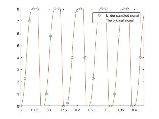

A periodic signal can be sampled by using sub-Nyquist sampling rate. This is well exploited in oscilloscopes. There one sample is saved for each signal repetition, but at a different position of the period. Need 512 samples? then 512 full perions of the signal is needed.
The accuracy:
Its easy to see that a stationary sinewave can be captured this way. But those 512 samples must cover the signal. That's true if 256th and upper harmonics can be considered as zeros.

Here is a code to show how to reconstruct the original signal from under-sampled signal. The original signal needs 1/100 sampling period to reconstruct its unique pattern (although its fundamental frequency is 8/100). By sampling with 1.5/100 sec sampling period, the original signal's pattern is reconstructed almost perfectly with reconstruction sampling period of 0.5/100. (In shortly, 0.5/100 sampling period is made from 1.5/100 sampling period.)
dt = 1/1000;
t = 0:1/1000:1.28-1/1000;
x1 = 10000*t(1:20).^2;
x2 = -10000*(t(21:40)-0.04).^2+8;
x3 = 8*ones(1,20);
x4 = -800*t(61:70)+56;
x5 = zeros(1,10);
x = [x1 x2 x3 x4 x5] ;
x = [x x x x];
x = [x x x x];  % make x to be periodic
dtz = 1.5/100;
tz = 0:dtz:1.28-1/1000;
z = x(1: round(dtz/dt) : end);
figure('Name', 'undersampled signal');
plot(tz,z,'o',t,x,'-')
legend('Under sampled signal', 'The original signal')
figure('Name', 'Reconstructed signal');
plot(t(1:5:160),z(mod((0:31)*11,16)+1), 'o-',t(1:160),x(1:160), '-');
legend('Reconstructed signal', 'The original signal')
Gaster
  • This could be made a lot clearer. What technique are you using to reconstruct? Where do the magic numbers in "z(mod((0:31)*11,16)+1)" come from? Also, the fundamental PERIOD is 8/100, not frequency - but what matters for Nyquist is the HIGHEST frequency present. – Selvek Nov 02 '18 at 20:33
