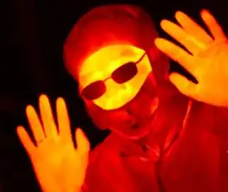

T2SL MWIR Image of a Man
This image was produced using an uncooled ("hot") T2SL MWIR (3-5 μm) Detector. It has better contrast than a high quality LWIR Image.
Using SWIR permits seeing through common glass (and using conventional lenses) but only very hot objects (Engines, Fire, etc.) are readily discernable without reflected light which is required to see anything that isn't very hot. Using LWIR is better for exact measurement of temperature but requires expensive Optics and unless you're using Microbolometers you'll need cooling.
MWIR cameras are employed when the primary goal is to obtain high-quality images rather than focusing on temperature measurements and mobility.
The MWIR band of the spectrum is the region where the thermal contrast is higher due to blackbody physics; while in the LWIR band there is quite more radiation emitted from terrestrial objects compared to the MWIR band, the amount of radiation varies less with temperature (see Planck’s curves): this is why MWIR images generally provide better contrast than LWIR.
For example, the emissive peak of hot engines and exhaust gasses occurs in the MWIR band, so these cameras are especially sensitive to vehicles and aircraft.
