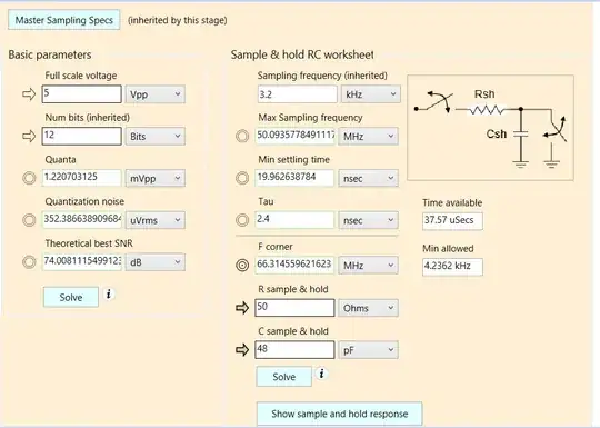

Here is the Sampling Worksheet[for 12 bits, with ADC grabbing a sample in the very last point of that settling] from Signal Chain Explorer enter image description here
