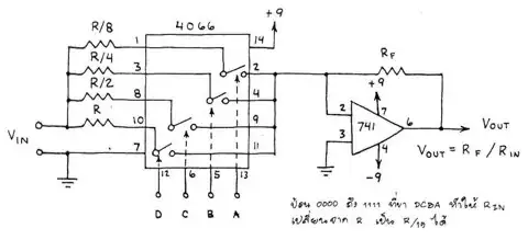

Digital programmable gain using a CD4066: -
The "switches" inside the CD4066 are basically mosfets acting as either "on" or "off".
Digital programmable gain using MOSFETs: -
A mosfet as shown above can be simply presumed to be either open-circuit or short-circuit (just like a relay contact or switch). With the three mosfets open circuit, the gain is -(R2+R3)/R1. With one mosfet selected (by applying a proper gate voltage level), the feedback is reduced and the gain increases. You can choose values for Ra1, Ra2 and Ra3 to produce gains that change like this: -
Information taken from here (Digitally Programmable Amplifier Meets Sensor Gain, Ranging Needs).
