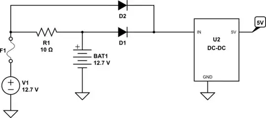

Considering you need to place the circuit inside your car, I would use 12V sealed lead acid battery instead. LiPo will be dangerous if it gets too hot.
V1 is the voltage from your ciggy plug and it comes with a built in 1A fuse. You would not want to add big capacitor as the high surge current will burn the fuse.
R1 10 ohm (5W maybe) is being use to charge your Bat1, you don't need an additional charger because your alternator can do it. D1 and D2 are schottky diode with a 0.2V forward voltage; trying to reduce power lose.
When V1 supply cut off, Bat1 will supply to your DC-DC to ensure your 5V is still there.
