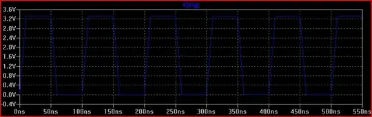

To guarantee clamping voltages, I would normally use a pair of schottky diodes with a series resistor (to limit the clamping current) and a small capacitor (not always possible - high speed data lines are the very devil to properly protect).
With schottkys, be careful of reverse leakage; a properly chosen part will be ok, but the leakage is exponential with temperature and can cause thermal runaway in certain circumstances.

    Just a nit pick: if you can afford 100R and 1nF to ground on a pin, you most likely don't need any extra ESD protection. – Ale..chenski Jan 08 '17 at 16:55
