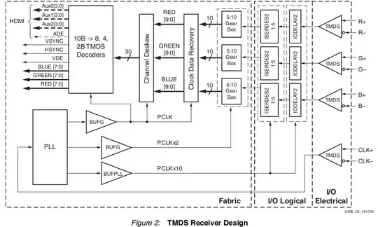

Here's a figure taken from the first application note showing the basic premise of the receiver:
from Xilinx App note
Since the Spartan 6 has got built-in SERDES hardware, these can be used as part of the deserialisation process. There is a synchronisation process which recovers the clock and ensures that the channels are all in-sync. Finally, 8b/10b decoding is applied to produce the RGB channel data.
Once the video signals have been recovered, You can then forward theses signals on to whatever processing you want to do, or on to a encoder which will send them out of the HDMI ports again.
